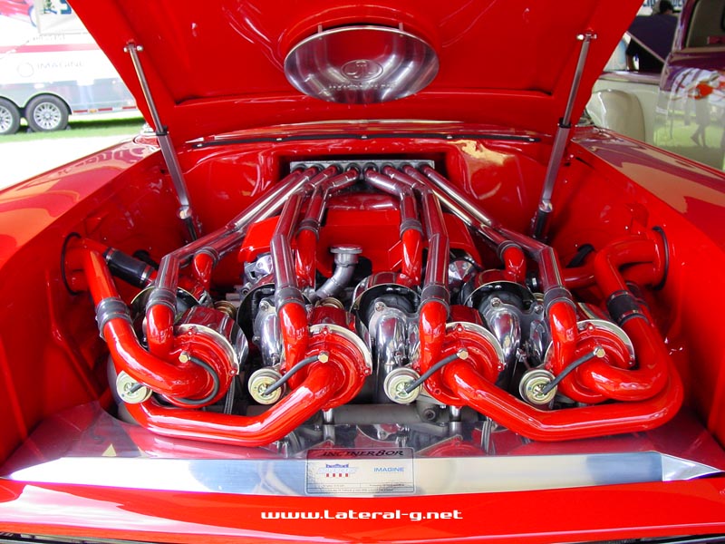

Eller 8 =D>
turbo8.jpg [ 135.56 KiB | Vist 3228 ganger ]
