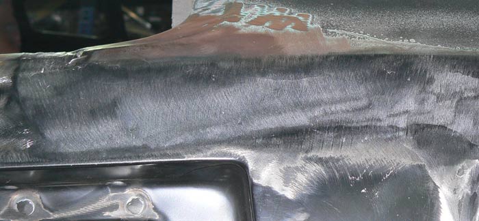

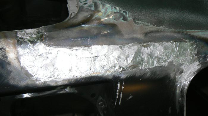

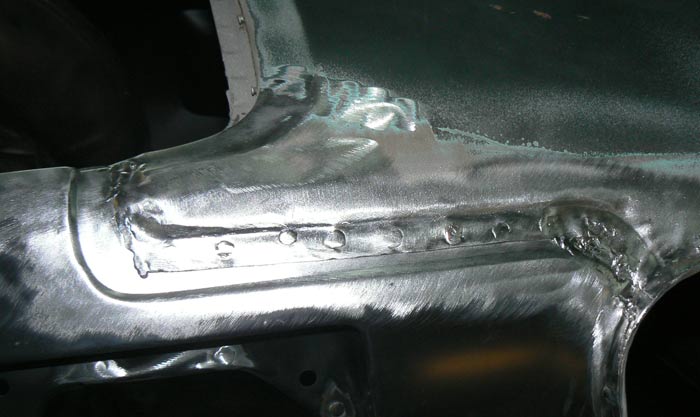

Here is some tining pictures, step by step... when You do tining, it is possible to play with it, to get ideal structure, without use any putty later, but I prefer to leave it as is, and use a little fiberglass putty on it by painter.

Tinn job is hard work, and much harder than normal filling.
the workshop that I worked for we had one of those old men, he only used the tin, while the others enjoyed the filler.
there is one thing that I'm a little afraid when you do not sand the surface smooth after tinning.
there can be air and acid trapt in the growe.
we have a lot of good body worker on Amcarforum, is it true what my old mentor said that the tin had to be blank after the job was done, due to the risk of acid and air ? or is this something he just said, (look extra nice)

Yes, it is hard job, but the worst is that taking lot of time. There for sure is not any air or acid inside. After first primer layer of tin I am cleaning all acids, and think 99,9% is cleaned. Then the final tin is putted. This hole is factory soo deep (around 5mm) that over a metal we have 4-5mm of tin. I can sand it a little bit more, to get ideal flat (smooth) suface, but then will have to use more filler on it. On a final picture there are visible some groves, but the groves are around 0,5mm or something. There are no holes to a metal or tin cracks. I can play with it, lost another hour and get ideal structure... but I am mixing 2 ways in a places like this. Simple tin, and thin layer of new kind putty on it.
If on a places like this we will use only new putty (filler) there is werry high risk that putty "sit down" after some time or crack (aspecially on a places when we will have 5mm). So in this case finally here will be 4mm of tin, strong holding all on place and 0,5 mm of putty (filler). I am thinking that when we will connect old school with new one, and take the best from both will be the best for this project.
InnleggSkrevet: Tir 03. Jan 2012 00:57
Yes these are the 0.5 mm grower I was a little afraid, that's where my mentor said it could collect air and acid, do not know if the acid comes from the flux or the tin. Maybe he is wrong, and he told me this only for trying to get the finnish result 100% nice. I was only 20 years old and he was old and wise you know its hard to be a apprentice :)

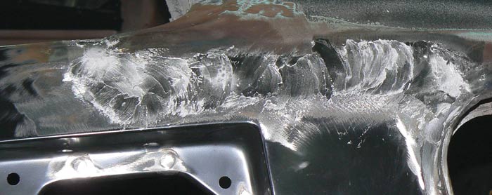

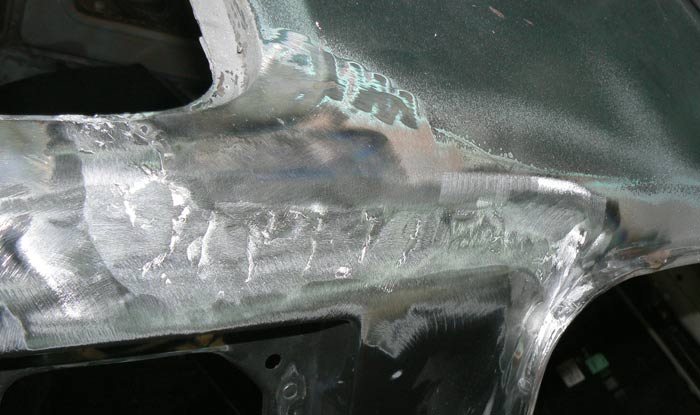

I was not able to sleep tonight... still thinking that You are not happy with this work ;-) so here is a result when I add 2 hours more to this work... still not perfect, but more close... ;-)

Lol. i have to stop making coment on pictures, i will not have angry magda calling meg " Furky can not sleep, he has become a Amcarforum addict"
I know Bead-lock know a lott of body work i hope He can make a notis on this tin work. if my mentor is wrong, its good for all to know. spesial me, then i can go home and "kill him" :D
