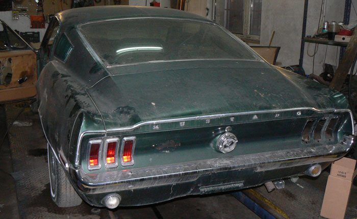

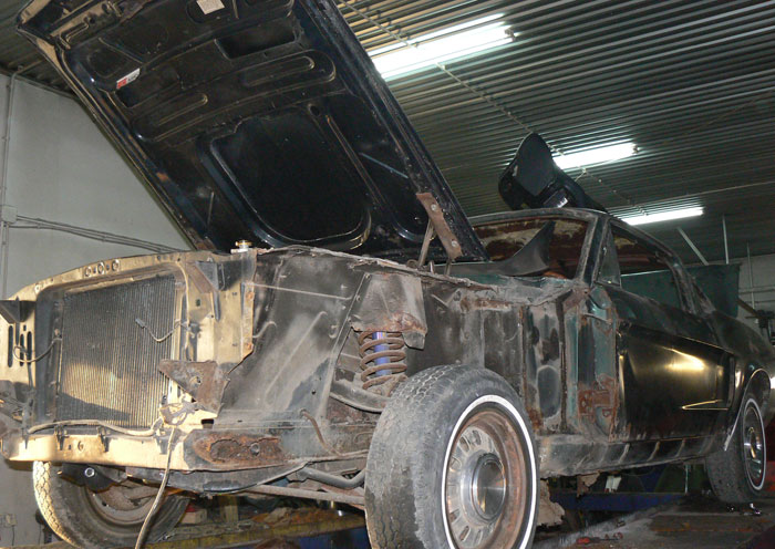

It is a 1968 Mustang Fastback. At the first look, aspecially on pictures, it do not look so bad ;-)
Filkommentar: At the first look it do not looks bad...
68_1.jpg [ 77.77 KiB | Vist 8686 ganger ]
Filkommentar: just nice, almost untouched survivor...
68_2.jpg [ 69.9 KiB | Vist 8686 ganger ]

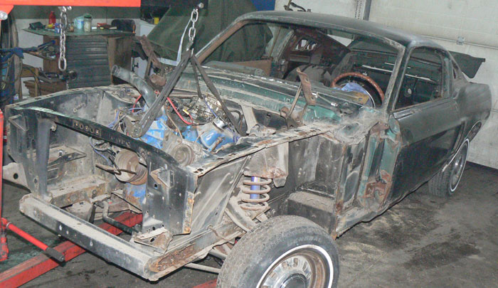

Taking the engine out of a car
68_23.jpg [ 91.59 KiB | Vist 8628 ganger ]

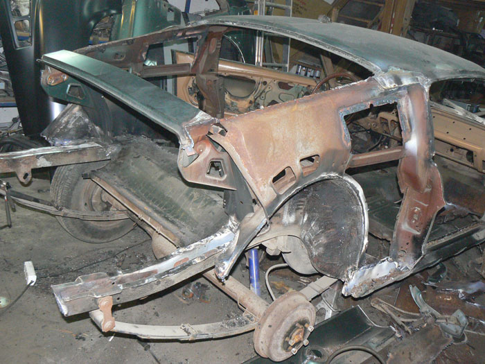

Then we start cutting, some panels, what need replacing....
This Mustang has rust in non expecting places.... Usually Mustangs rust similar... simple ewerything :lol: but this one has totally rusted back - trunk, quarters, etc - then rear framerails are like new...
At the front it look inversely - fenders are nice, inner engine room panels almost ok, but front frame rail do not exist....
68_24.jpg [ 84.11 KiB | Vist 8617 ganger ]

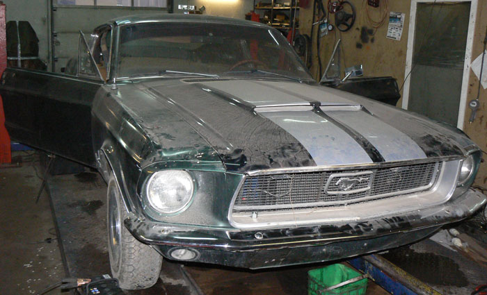

Yes... lot of work to do, and it is only the begining....
Here are some pictures, when car is ready for initial sanding. We are sanding first time not so carefully, just to clean metal a little bit, and see what else need fixing or replacing. I have my own sanding place, so can afford for fiew time sanding :). Of course we do not use normal sand :) It is kind of glass, the most important is that this material do not keep moisture (water) when You leave something in a car. (It is normal, that You are not able to remove all sand from a car - some of them will be forewer in a framerails, or hidden places)
68_27.jpg [ 84.03 KiB | Vist 8516 ganger ]
68_28.jpg [ 88.46 KiB | Vist 8516 ganger ]
