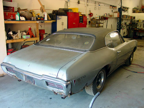

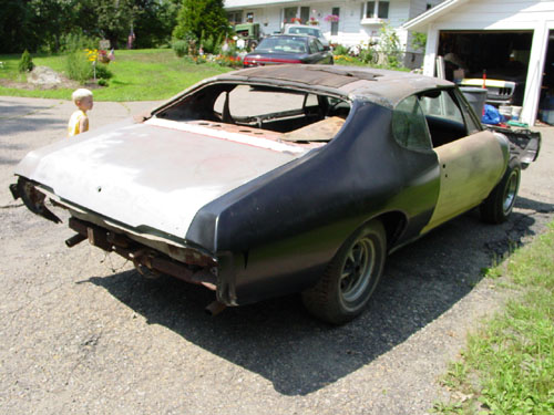

Hallo Igjen,
Her er noen bilder av min GTO , bilen opprinnelig innehaver kjøre inntil 1990s ,Jeg tenker han vasket bilen siste gang i 1978 :lol: :lol:
Rear r.jpg [ 69.89 KiB | Vist 8398 ganger ]
Filkommentar: Dag det komme hjem..
FRr.JPG [ 123.69 KiB | Vist 8398 ganger ]

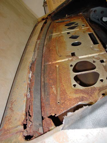

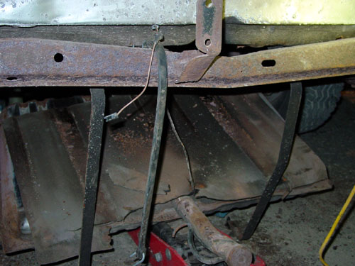

Rot...Rot...og ROT :!:
REAR DEACK PANEL ROT.jpg [ 62.59 KiB | Vist 8398 ganger ]
trunk rot.JPG [ 204.02 KiB | Vist 8398 ganger ]

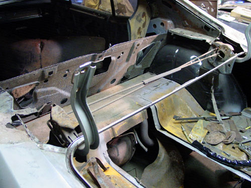

Had to find a used tail panel....then weld in place
tail installed.jpg [ 82.91 KiB | Vist 8394 ganger ]
Filkommentar: Major surgery...
tail gone.jpg [ 92.43 KiB | Vist 8394 ganger ]

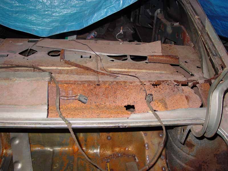

Package tray shot also.. :?
Filkommentar: Removal of package tray
package tray.jpg [ 80.42 KiB | Vist 8395 ganger ]
deck rot.JPG [ 226.7 KiB | Vist 8395 ganger ]

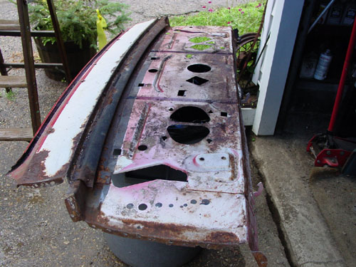

Found a salvageable used one ,trim to fit like a factory panel

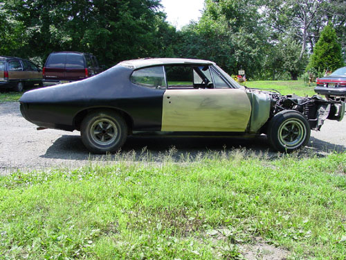

nå hvem rear er solid igjen ,time for indre og outer hjul hus,quarters og rocker panels
pass2.jpg [ 106.86 KiB | Vist 8378 ganger ]
pass.jpg [ 75.81 KiB | Vist 8379 ganger ]
p-quarter.JPG [ 185.08 KiB | Vist 8379 ganger ]

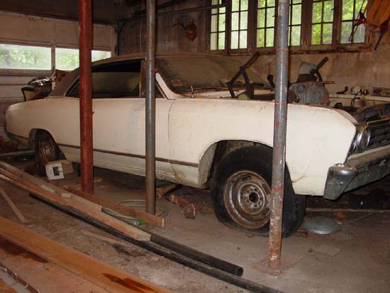

Tusen Takk for kommentere :!: Pappa Wolf ,I guess I'm kinda lucky my wife understands to a limit..This is her car ,....well our's :) Her mom purchased the car new in '67 ,it has sat in this spot since 1974(problem med powerglide)She was 4 last time she rode in it,she want's to drive it soon!! That is another project for another day :wink:
Mom's 67.jpg [ 54 KiB | Vist 8307 ganger ]

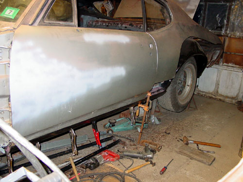

Rocker Panel
rocker-inner.jpg [ 68.18 KiB | Vist 8295 ganger ]
test fit.jpg [ 73.05 KiB | Vist 8295 ganger ]
rocker.jpg [ 75.43 KiB | Vist 8295 ganger ]
