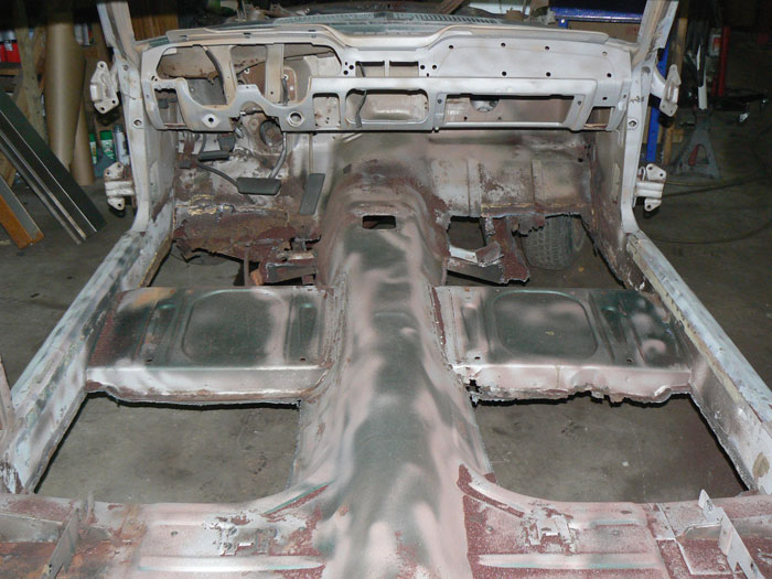

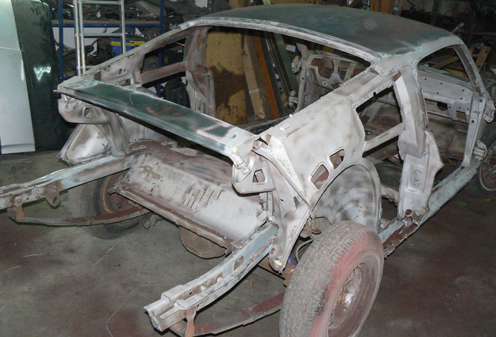

And after initial sanding here we have the same car, but little more clean :D

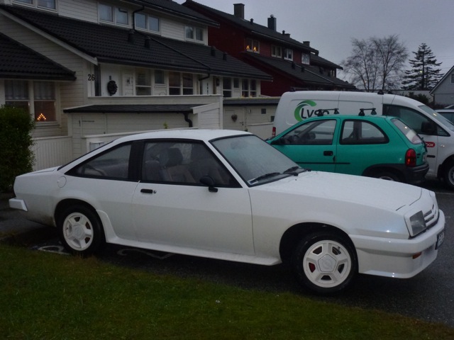

yes :) sjekk den hvite bilen i bakgrunnen =D>

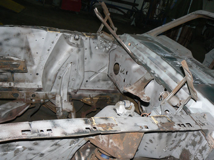

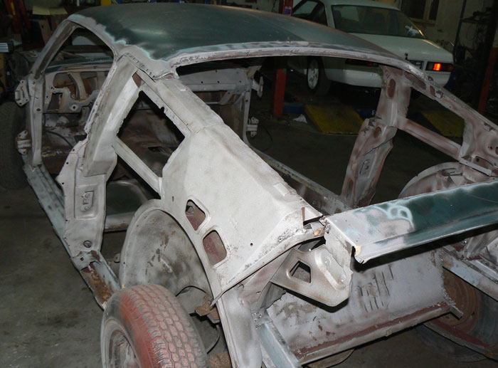

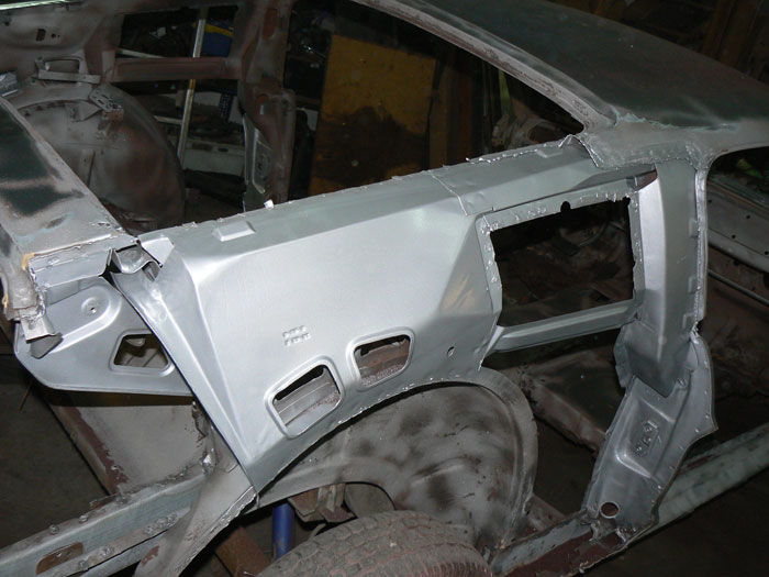

We are actually do not touch flat places, like roof, hood, fenders or quarters (if are usable) with sand. We did it in past, but ewerytime (even if the air presure was low, or amount of sand las low) painters feel small deformations. So now we only clean flat places around, and clean all what is hidden with sand - then flat places clean by hands, with special tools. I do not know what I will decide with this roof, becouse it is in nightmare condition (some US was dancing on it :lol: )
så er din Manta! Like with every car putting back together.... every day more problems... and You see car, but can't enjoy ride. I was thinking that it will be esy with european car.... no way! I forgot to tell You... we do some test drive, like we discuss try to burn one set of tires.... and shaft between trany and rear end broke.... :twisted:

You should get a new sandblaster
InnleggSkrevet: Lør 03. Des 2011 23:52
what is better with a new type sandblaster versus old style, do the panel not twist, make less heat?
Why You think so? I have werry good stuff :) Waving come becouse of metod, not becouse bad machine. We have lot of experience with sanding, work only on low presure, but waves always can happen. It is not kind of waves like sinus +/- 10mm :D werry small deformations, possile to find only with touching and fingers... but after all it is more work for painter, and more filler on car - so better to take old paint with hands. If You was thinking, that we have to get soda blasting or something..... we has soda blasting, but soda do not work good with US rusted cars :lol: soda takes only paint (mostly new kind) old toxic paints and undercoats are hard to take out with soda (but possible), and US rust is not possible to clean with soda blasting

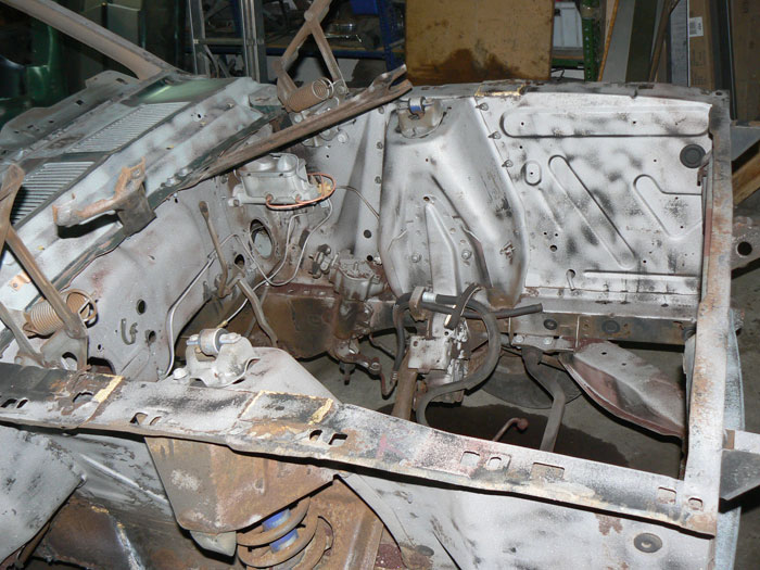

After sanding I has cover bare metal (at the place where it will be covered soon by new panel) with welding primer. Factory there was not painted area... why they do not secure metal inside at factory?

Regarding the bare metal issue: I think they did't paint the inside, because of the cost and labor with it. And the cars where suposed to last only a few years, and then you bougth a new one.

Men han kan ikke være 2 plasser til samme tid, han tok med seg White Christmas til Stavanger.
Som vanlig er jeg på jobb, så håper Janne tok godt vare på han og at han ikke ble sjøsyk over fjorden.hvit jul.jpeg[/attachment]
