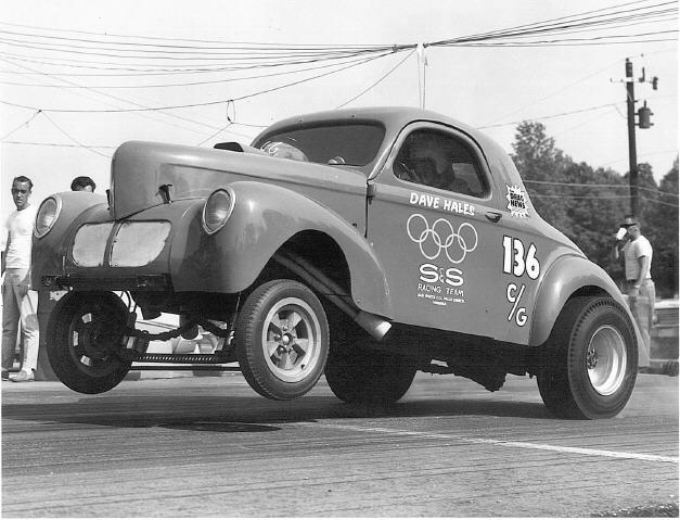

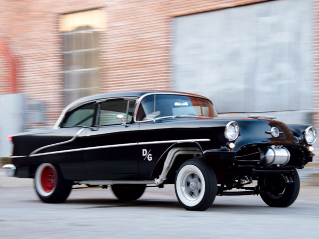

I like `em high, real men drive scary rides.
sa2.jpg [ 80.87 KiB | Vist 4950 ganger ]
hales1.jpg [ 53.67 KiB | Vist 4950 ganger ]
gasser1.jpg [ 58.76 KiB | Vist 4950 ganger ]
